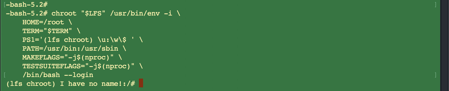

7.4 Entering the Chroot Environment
This is the threshold. The chroot command sets the root directory to $LFS, so from inside, / is the LFS filesystem. You stop being on the host and start being inside the system you are building.
chroot "$LFS" /usr/bin/env -i \
    HOME=/root \
    TERM="$TERM" \
    PS1='(lfs chroot) \u:\w\$ ' \
    PATH=/usr/bin:/usr/sbin \
    MAKEFLAGS="-j$(nproc)" \
    TESTSUITEFLAGS="-j$(nproc)" \
    /bin/bash --login
A few things that are normal and expected:
  • env -i clears the environment, then only HOME, TERM, PS1, PATH, MAKEFLAGS, and TESTSUITEFLAGS are set.
  • From here on the $LFS variable is not used. Everything is relative to /, which is now the LFS root.
  • /tools/bin is deliberately not in PATH, so the cross-toolchain is no longer used.
  • The prompt shows I have no name! because /etc/passwd does not exist yet. This is expected and gets fixed shortly.

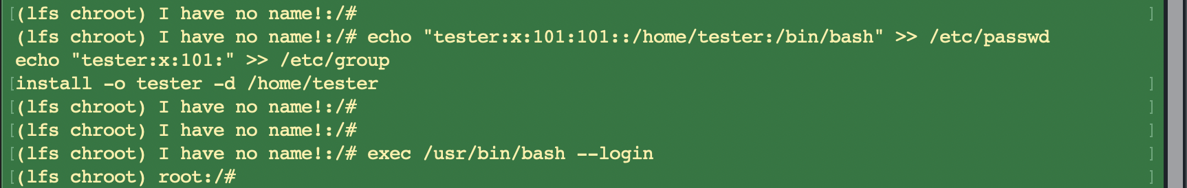

Add a temporary tester user needed by some Chapter 8 tests (removed at the end of that chapter):
echo "tester:x:101:101::/home/tester:/bin/bash" >> /etc/passwd
echo "tester:x:101:" >> /etc/group
install -o tester -d /home/tester
Now start a new shell so name resolution works and the prompt fixes itself:
exec /usr/bin/bash --login
The prompt changes from (lfs chroot) I have no name!:/# to (lfs chroot) root:/#.

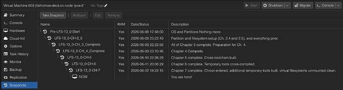

Backup: snapshot instead of tar
The book offers an optional tar backup of the temporary system. On Proxmox a VM snapshot does the same job faster, so I snapshot instead of creating the tar archive. The snapshot captures the temporary system state for rollback if Chapter 8 goes wrong.
The clean way to do this is to exit the chroot and unmount the virtual filesystems before snapshotting, so the snapshot is not taken with the kernel filesystems mounted.
exit
echo $LFS
mountpoint -q $LFS/dev/shm && umount $LFS/dev/shm
umount $LFS/dev/pts
umount $LFS/{sys,proc,run,dev}
Verify Before Snapshotting: A Caught Issue
This is worth documenting. After running the unmount block, I verified rather than assuming:
findmnt | grep /lfs
The check showed all six virtual filesystems were still mounted. The unmount commands had not taken effect, likely because the pasted block collided with the chroot exit. Had I snapshotted at that point, the snapshot would have captured mounted virtual filesystems.
The fix was to unmount them one at a time, checking each, then verify again:
umount /lfs/dev/shm
umount /lfs/dev/pts
umount /lfs/dev
umount /lfs/sys
umount /lfs/proc
umount /lfs/run
findmnt | grep /lfs
After that, findmnt showed only the /lfs root partition (the ext4 on /dev/sda4), which is correct, that stays mounted. All six virtual filesystems were cleanly unmounted.
Lesson: always verify the unmount with findmnt before snapshotting. Do not assume a pasted block of umount commands all succeeded. The cautionary check before moving on is exactly what caught this.
