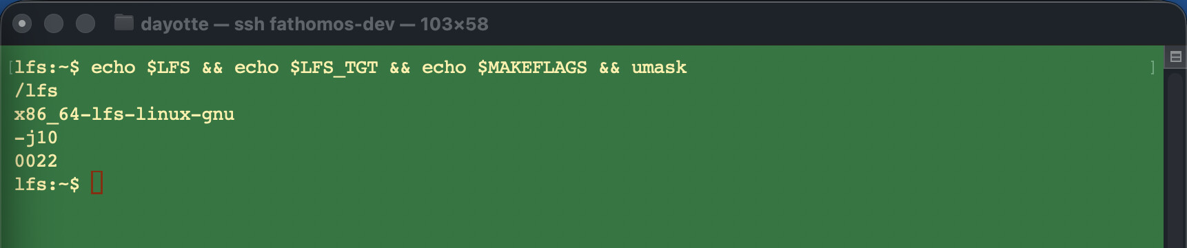

Same as Chapter 5, every package in this chapter must be built as the lfs user with the correct environment. If you SSH in, you land as your normal user, not lfs. Switch with a login shell and verify before doing anything:
su - lfs
echo $LFS && echo $LFS_TGT && echo $MAKEFLAGS && umask
You want /lfs, x86_64-lfs-linux-gnu, -j10, 0022. The book repeats the warning that improper LFS setting combined with building as root can render the machine unusable, so this check is not optional.

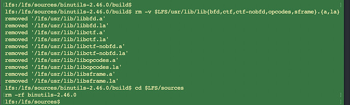

make DESTDIR=$LFS install
rm -v $LFS/usr/lib/lib{bfd,ctf,ctf-nobfd,opcodes,sframe}.{a,la}

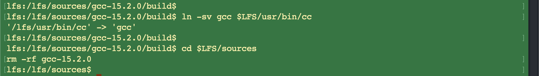

ln -sv gcc $LFS/usr/bin/cc

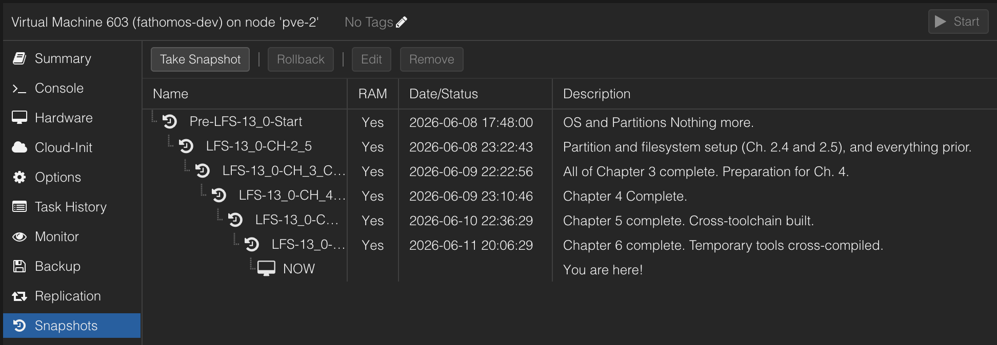

Snapshot
With the temporary tools cross-compiled, this is a good point to snapshot before entering the chroot in Chapter 7. A clean rollback point here means the whole temporary toolchain does not have to be rebuilt if something goes wrong later.
