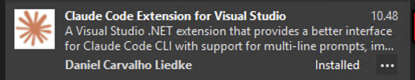

Step 1: Install the Visual Studio Extension
  1. Open Visual Studio 2022.
  2. Go to Extensions, then Manage Extensions.
  3. Search for Claude.
  4. Install Claude Code Extension for Visual Studio.
  5. Close Visual Studio once the install completes. The extension actually finishes installing on shutdown, so this part matters.

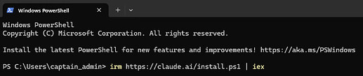

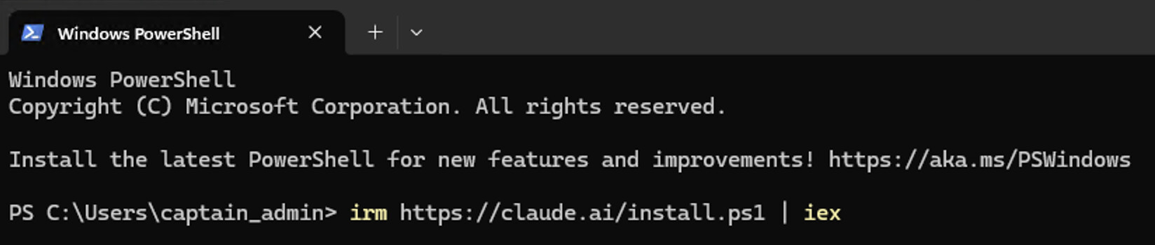

Step 2: Install Claude Code via PowerShell
  1. Open PowerShell.
  2. Run this command:
irm https://claude.ai/install.ps1 | iex
  1. When the installer finishes, it prints a folder path and tells you to add it to your environment variables. Copy that path somewhere you can grab it in a second.

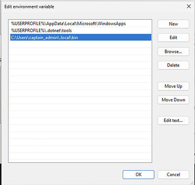

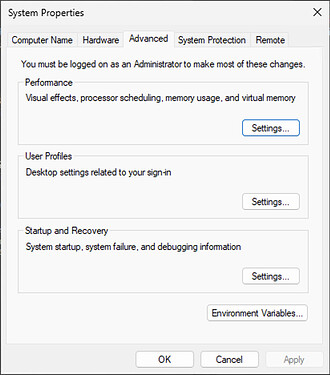

Step 3: Add Claude Code to Your PATH

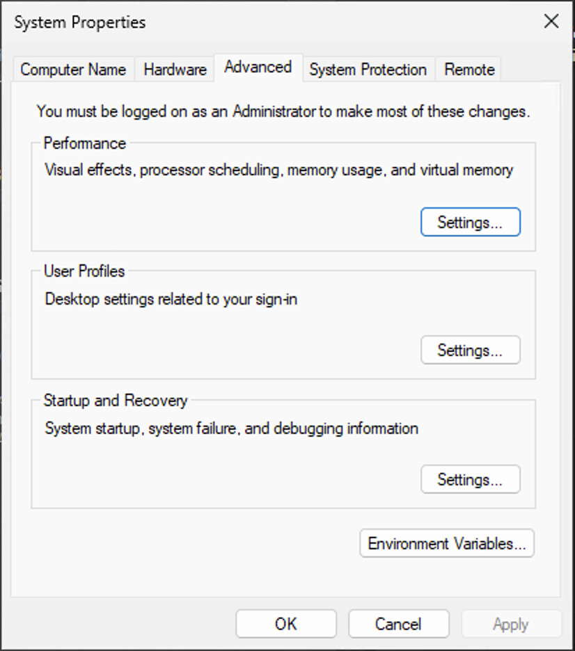

  1. Press Win + R, type System Properties, and hit Enter.
  2. Click Environment Variables at the bottom of the window.

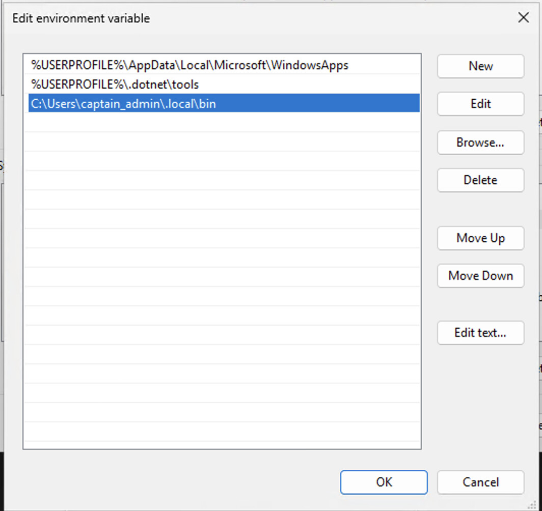

  3. In the top section (User variables), select Path and click Edit.
  4. Click New.
  5. Paste the path from Step 2.
  6. Click OK on all three dialogs to save and close.

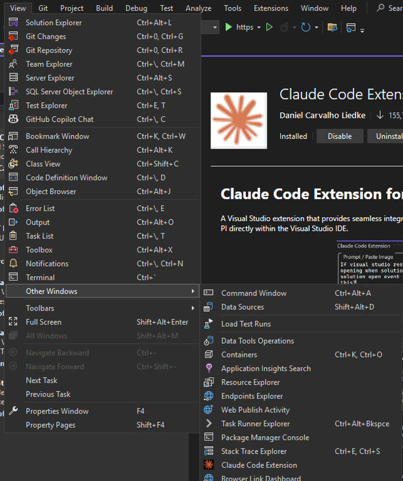

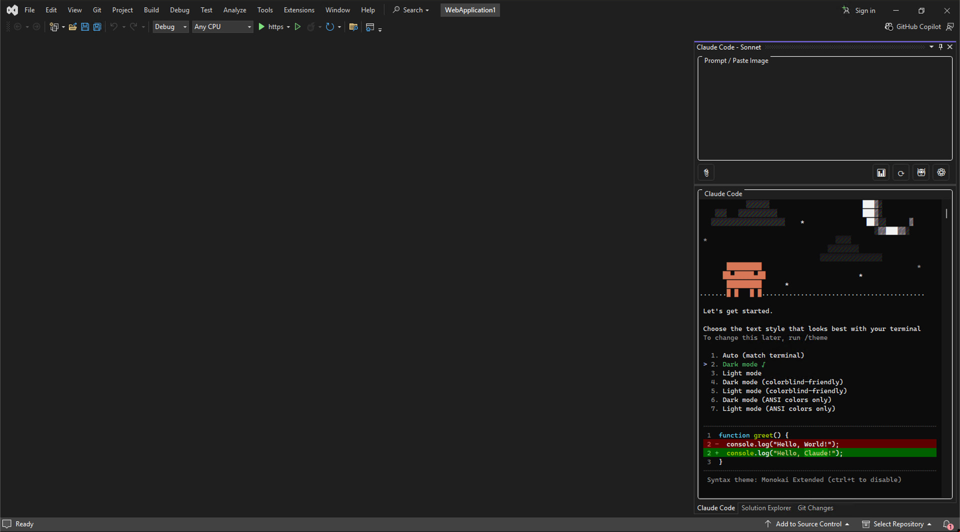

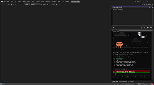

Step 4: Verify Everything Works
  1. Open Visual Studio 2022 and follow any first run prompts the extension shows you.
  2. If the Claude panel doesn’t appear on its own, go to View, then Other Windows, then Claude.
  3. Sign in when prompted and you should be good to go.

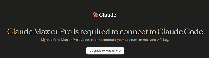

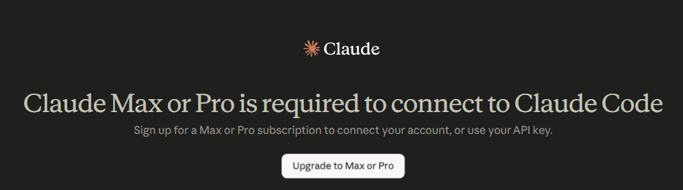

Hey @CaptainDumbass ,
I went through the steps in VS and got to the sign in page for Claude in VS2022 and was greeted with a message stating Claude Max or Pro is required to hit the API key. Not sure if I did something wrong or if that’s part of it?
I attached a screen shot of what popped up. Solid guide!!
Quick note, I should have caught that in the original guide. Since I already have a Pro subscription, I didn’t run into the paywall myself and overlooked calling it out as a requirement. Thanks for flagging it so others know what to expect going in. I’ll update the guide to make the subscription requirement clear up front.
Thank you for confirming the steps worked. This is expected since it requires at a minimum the $20/month Pro subscription. The free version can’t connect, sadly. That said, the quality of the help is worth the $10 difference over what Copilot charges if you go with the paid version. Of course, this is just my experience and preference. Your mileage may vary. I just wanted to share the option for anyone who would like to use Claude. I appreciate the post and feedback.
Happy to test out the steps listed above and provide confirmation that they worked!
I have had a few other colleagues from the past suggest purchasing the Claude Pro version for $20/month stating that they have found it very beneficial so, I am going to pull the trigger and purchase it myself.
Much appreciated. The disclaimer has been added to the post towards the top. Again I appreciate you pointing it out and sharing for all to see.
